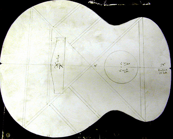

PostPosted: Fri Sep 15, 2006 3:13 am
I redesigned the bracing all together, as just shifting my existing pattern didnt really look right, it was simply too far back from the soundhole. So I ahd to close up the X to 90 degrees, and make the bridge wings a little longer, and it seems to have worked out fine. A for tuning baritones, heres what some big names do ....

Please tell me you have some photos of your bracing for the baritone!
-j.

PostPosted: Fri Sep 15, 2006 6:53 am
Sorry no pix of the actual top braced up, but here is the 29 inch pattern.
